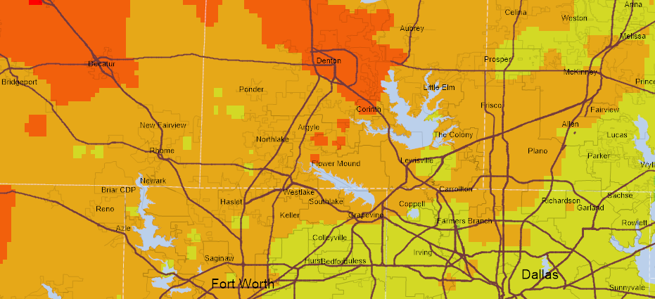

Do you have point data that you would like to make more visually appealing? If so, consider representing the data as a Grid. A Grid is a raster format that allows you to divide a geographic space into equal sized cells each representing a value with an attribute (i.e. elevation, surface slope, soil pH, etc.) for that unit of space. Each Grid cell is referenced by its x, y coordinates. Typically a Grid file is created based on some sample points with known values.
In this wiki sample, we create a Grid file based on point shapefile representing soil pH values in a field. Using the inverse Weighted Distance algorithm for interpolation, we create the Grid with the pH value for the entire extent of the field.
