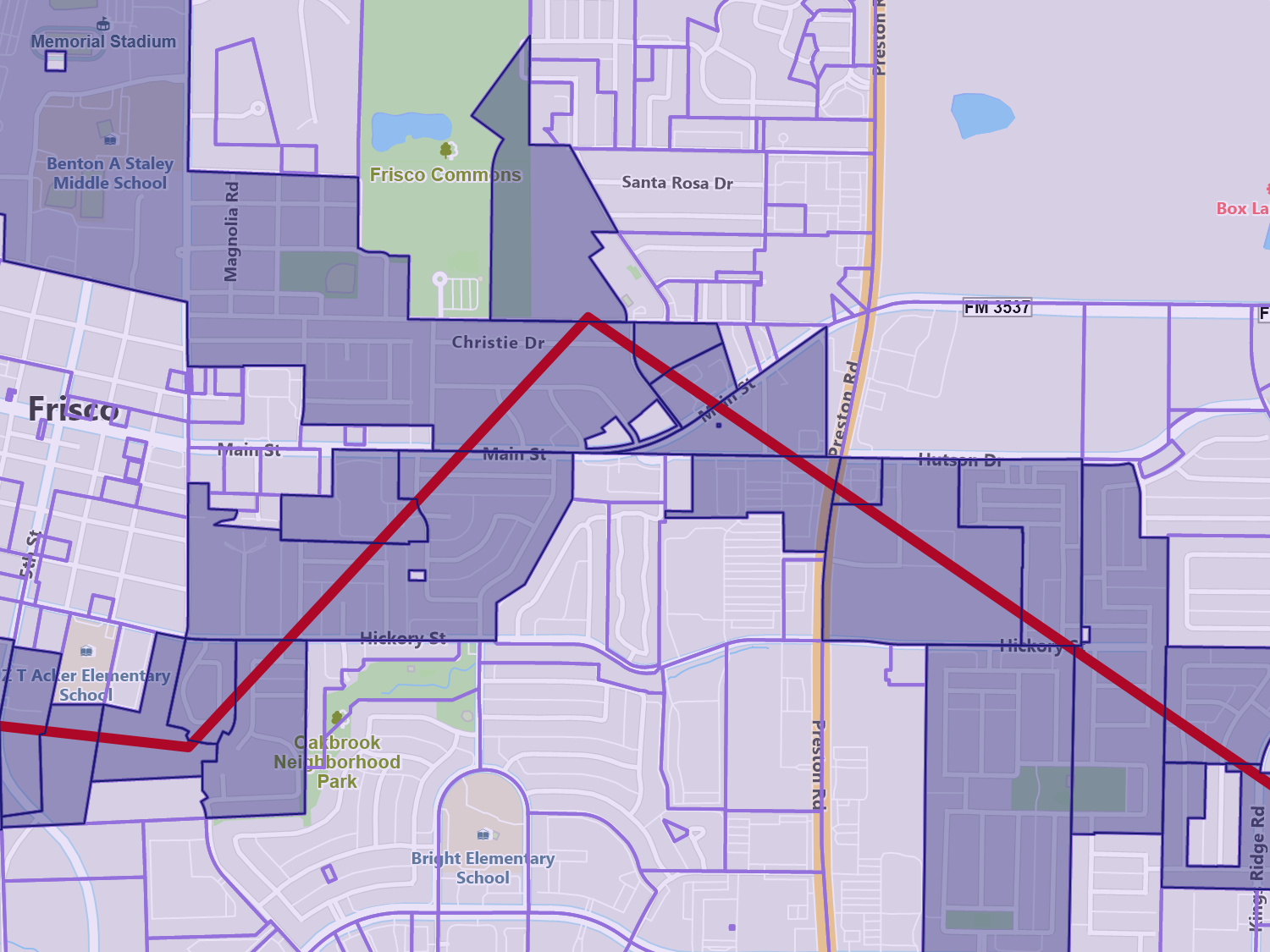

Crossing
Crosses finds features where a line, point or set of points crosses another line or polygon. It is not designed to compare polygons since intersects and overlap covers for those operations.
A common example is finding lines that cross each other. In GIS, line networks, such as roads, are supposed to terminate when they intersect with another line. This, for the case of roads, denotes an intersection. For tunnels or overpasses, however, these lines will cross, which makes this method ideal to use in order to find those.
Another example would be to find where a line crosses a polygon. Let’s say you have a route and want to see if it avoids a certain area that you want to exclude driving in. You could use crosses query to find if the line crosses that exclusion area.

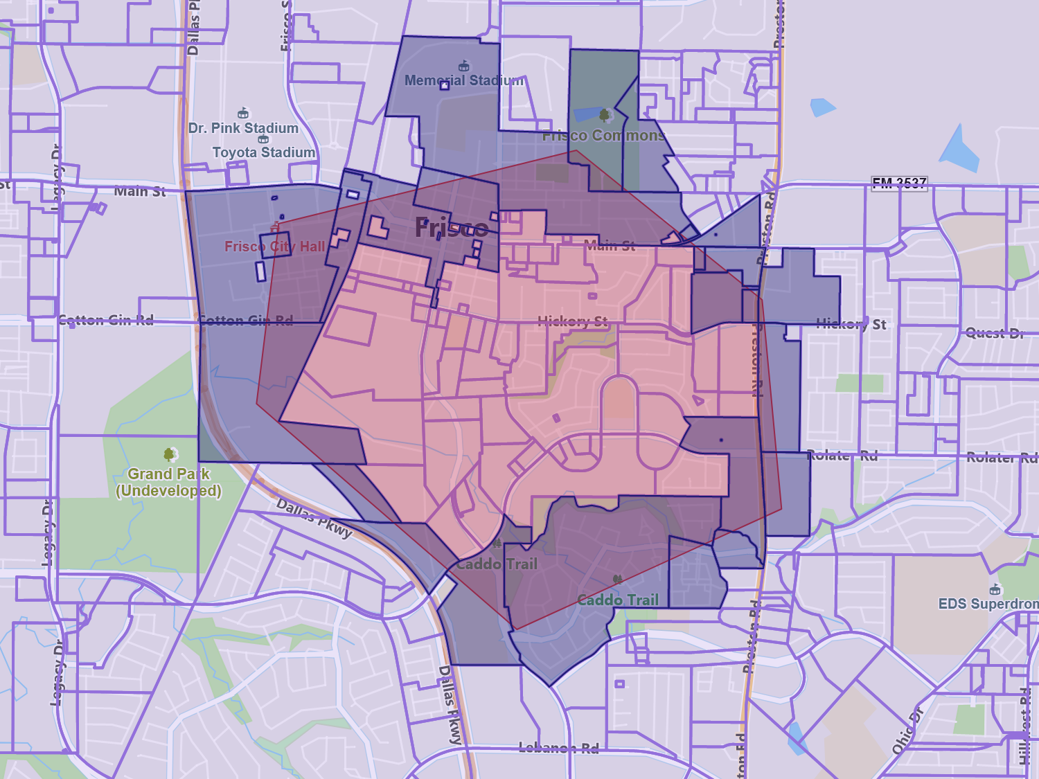

Intersecting
The intersecting query allows you to find all features that share a common space with a given feature. This includes features inside, overlapping, or border sharing. This is commonly used for querying shapes to see if a feature has any relationship with any of the other features in the dataset.
As it is the most liberal of the queries, it’s used often. A good example is finding all the features that are within the current map extent. If you take the current extent and choose a layer, such as roads, you will find all the roads related to the extent, even if a road only shares a part of the boundary of the extent.
Sample Code

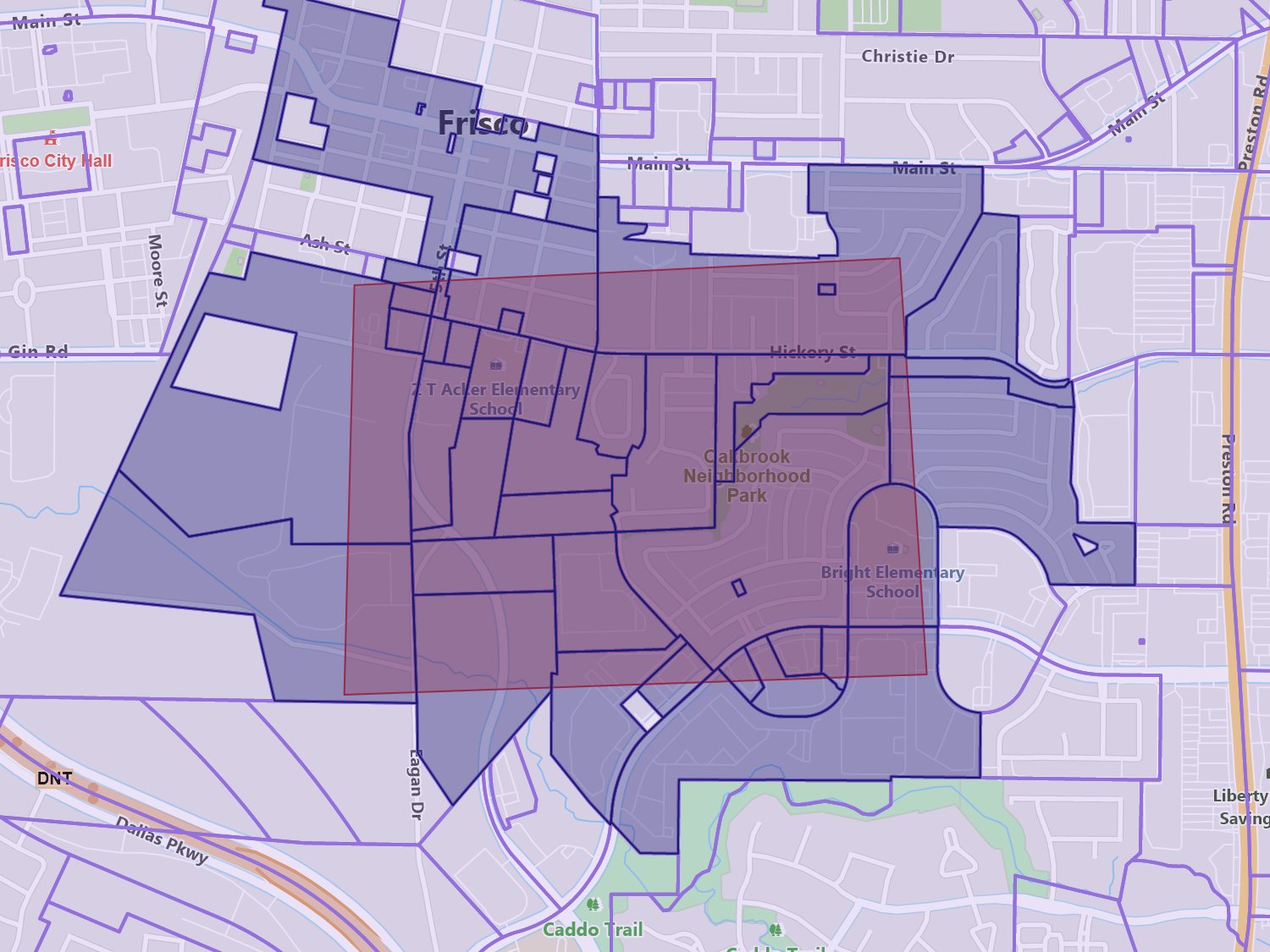

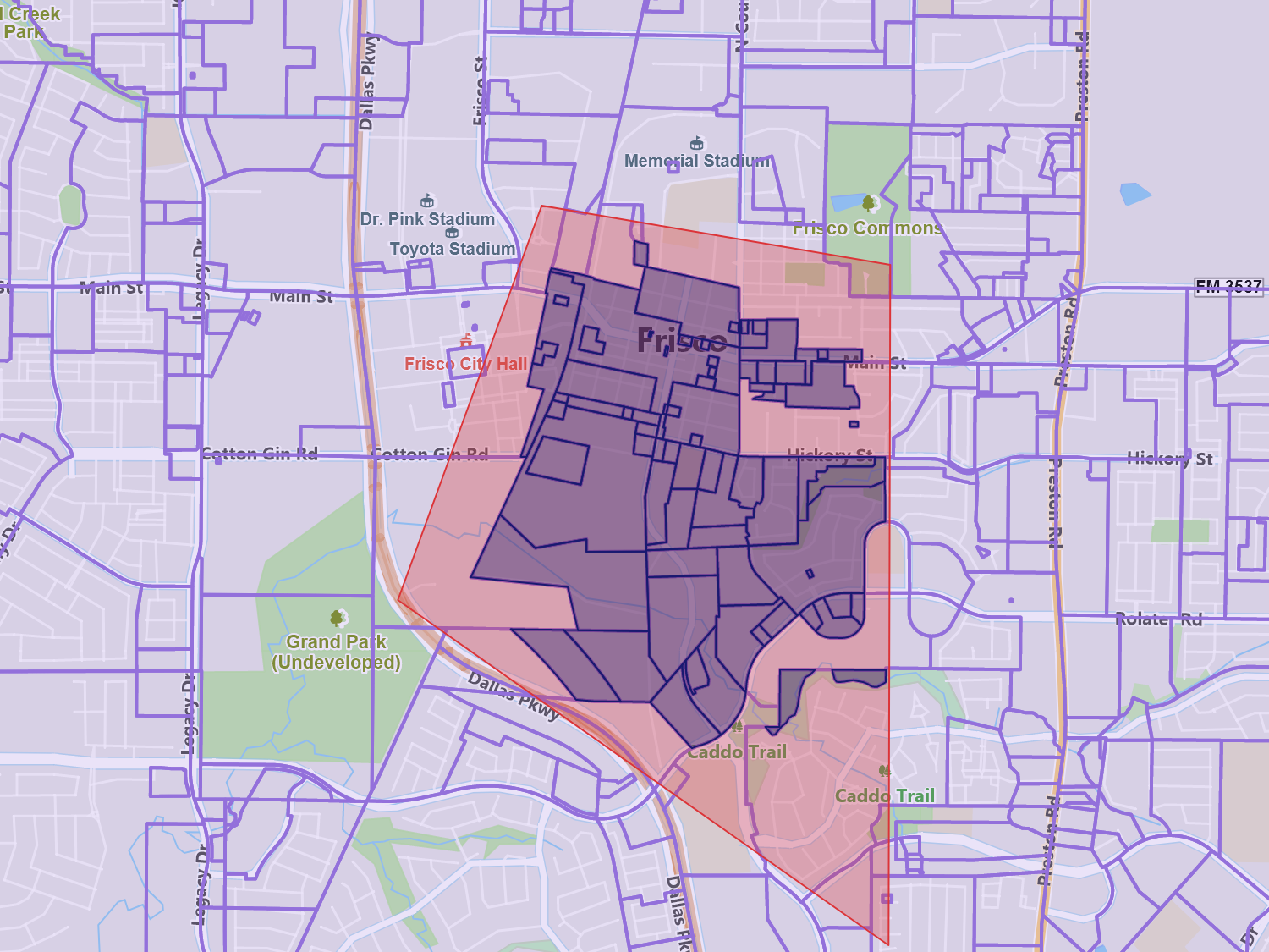

Overlapping
The overlapping query find shapes that share some of the same, but not all, of the same area.
A common use of this query might be to identify sales territories that may overlap other territories. Sales territories typically do not overlap. So, if you take a particular territory and run the query against the others, any matches might need to be adjusted so that those areas do not overlap.
Sample Code

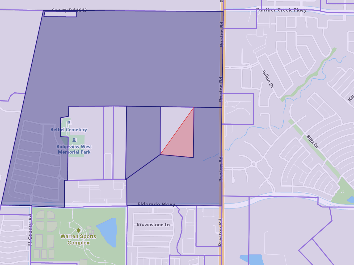

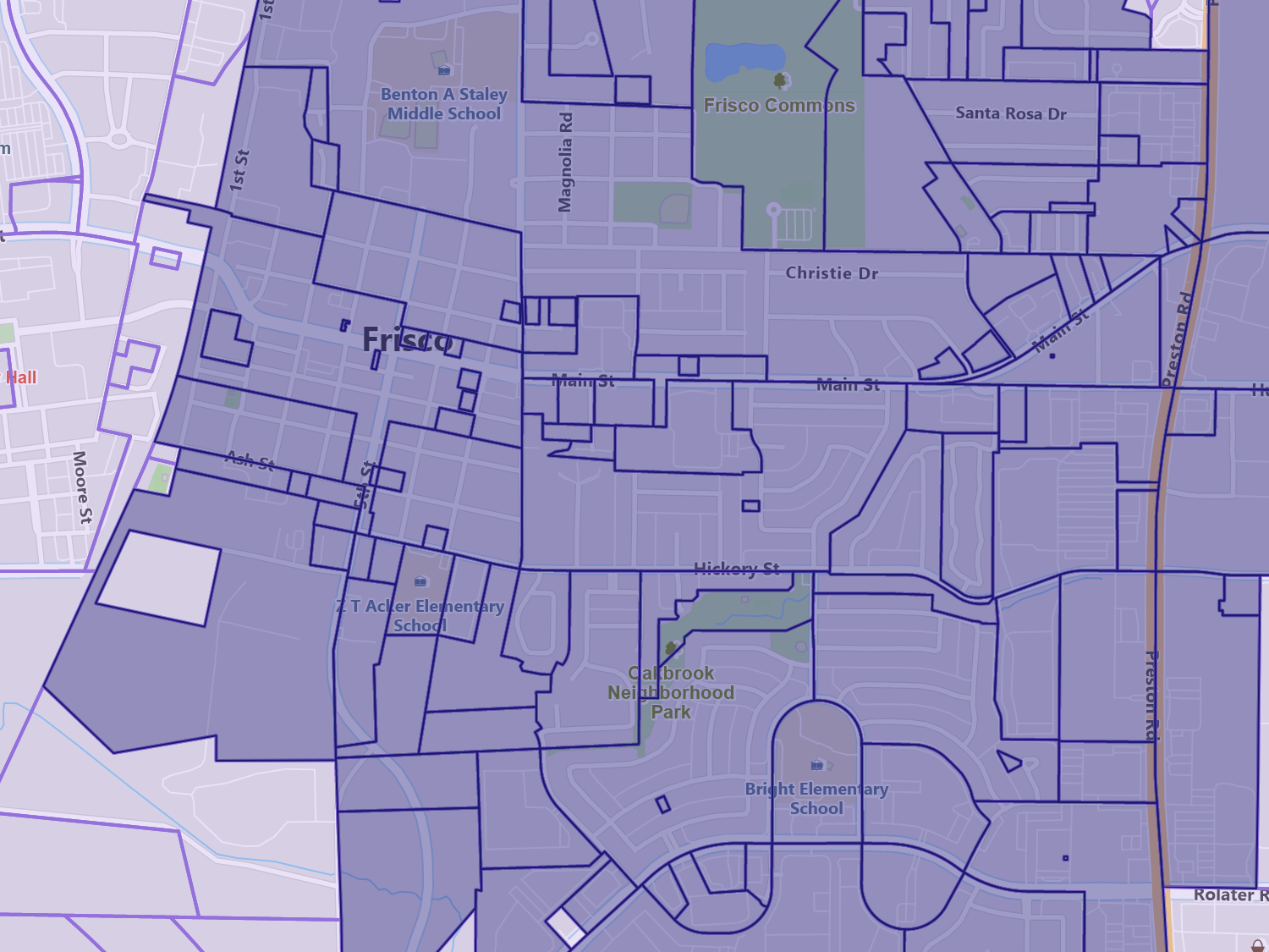

Within
This query is helpful in finding all the features of a layer that are totally within a given feature. If any part of the layer’s features extends beyond the feature passed in, then they will not be included in the result set.
An example for the Within query might be finding all the land parcels that are within a county, but don’t overlap with another county. Parcels that overlap another county will not be returned, but could later be found by using the Intersection query based on just the boundary of the county polygon.
Sample Code

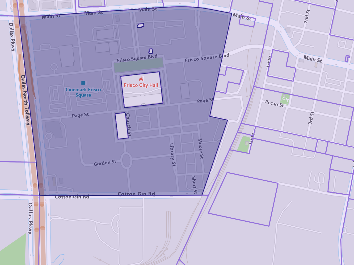

Touches
The Touches query allows you to find all of the features that share some part of a boundary, without overlapping, with another feature. It’s useful to find polygons that border other polygons, such as states that border other states.
Another example might be wanting to find all the streets that intersect with an intersection. You would pass in the intersection’s point, and this query would return all the streets that touch at that intersection.

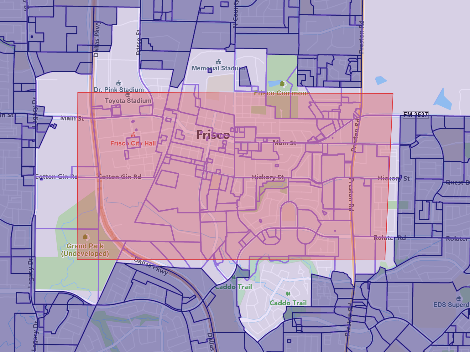

Disjointed
This query is the inverse of intersection as it finds all of the features in a layer that in no way intersects with the feature passed in. Though not as common as the intersects query, it is useful in specific situations, especially when paired with other operations.
An example would be if you have an existing marketing campaign that covers a two mile radius, and you want to see how many more households you could reach if you extended that radius another mile out. You could query the households layer, passing in the existing marketing campaign polygon, and it would return all of the features outside of it. Next, you could test each point to see if it is within three miles. As the first query already excluded the original two mile radius, we would only find the points between two and three miles out.
Sample Code

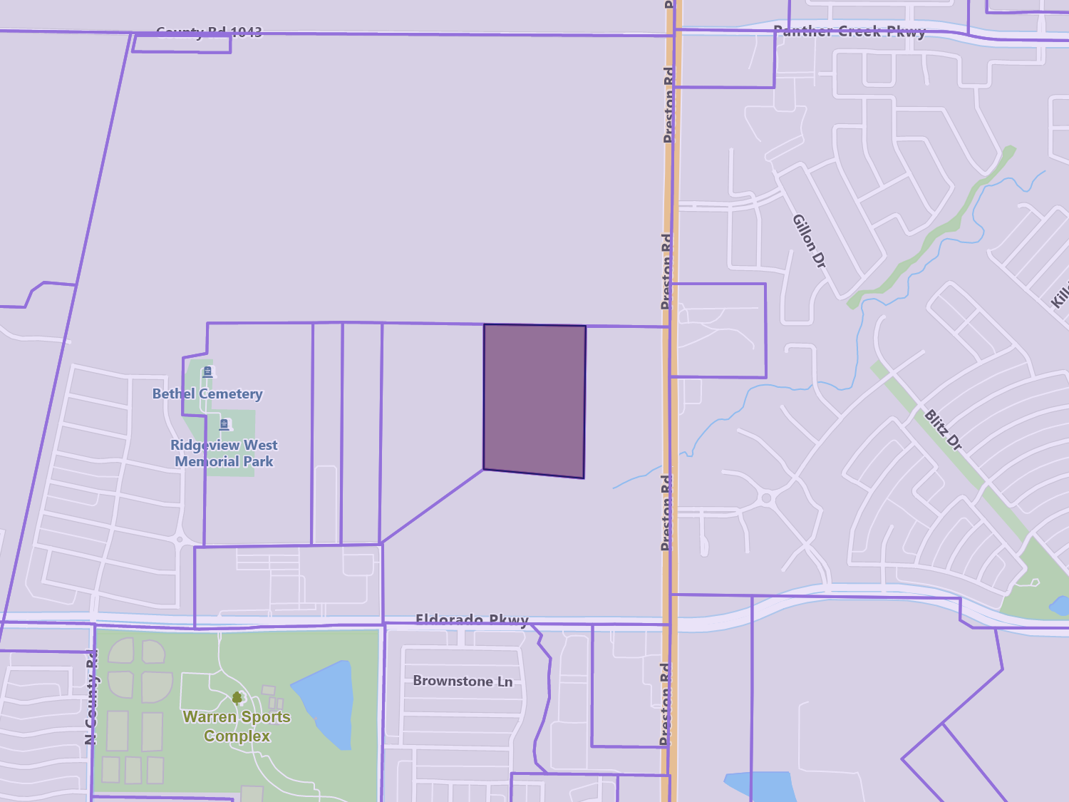

Equals
This query finds features which are topologically equal, regardless of their column data. At first glance, this doesn’t seem very useful. However, it’s great for finding duplicated data in your layers or as a test before you add new features.
As an example, you may be importing a new dataset you purchased and as you integrate it, you want to ensure that there are no duplicate entries. Before committing a new feature, you can do this spatial query to ensure no duplication of data occurs.
Sample Code
