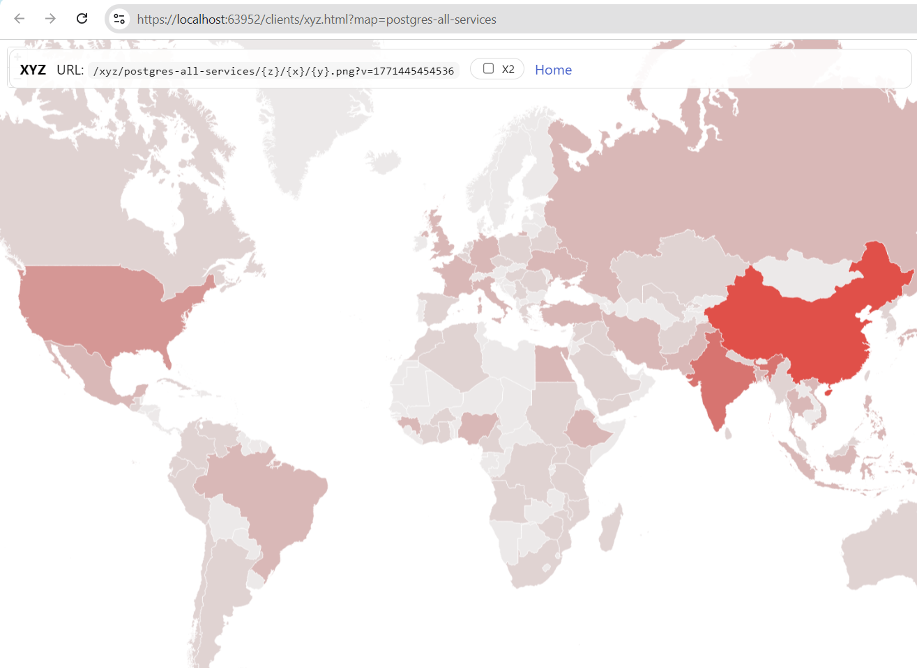

A simple class break style applied to the Countries table using the ‘pop_cntry’ column. Styling can be applied to any raster service. Vector services are typically styled on the client side.

In the code below, you can see how the PostgreSqlFeatureLayer is used to load data from the countries. Just pass the connection string in the constructor. Note: the data table needs to have one of it's columns defined as a geometry data type. A VectorLayerDefinition and RasterLayerDefinition are used to configure the layers with the appropriate data sources, projection converters and styling (for raster outputs). In this sample, a simple ClassBreakStyle is applied to each country based on the ‘pop_cntry’ column in the countries table.
